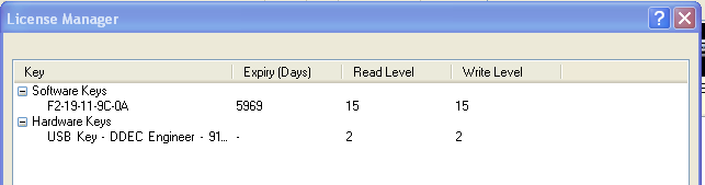

    Hi, I'm working on a dd15 the dpf ash clean code came on, i sent the filter to get cleaned, the truck has 320xxx miles. I tried to reset the dpf ash accumulator but it get me an error (can remember exactly what the error was, but it said something like the cpc exceded the milage....... sorry) I typed in the dpf serial number like it asked me. I have d d dl 7.06 read and write level at 15. Can someone please help me. Thanks.
    sv_sivk
    Guest
    ur typing in the original number that u sent to get cleaned is what the problem is. ecm is looking for different serial number from my experience.

    I tried to do this using DDRS 7.07 but need DDRS 7.03 harware level 4 help my
    the same DDDL 7.05

    the problem is in the driver install Nexiq Parallel Driver 2.0 and Nexiq USB Link Drivers 8.1.1.0 from the package DDDL 7.07
